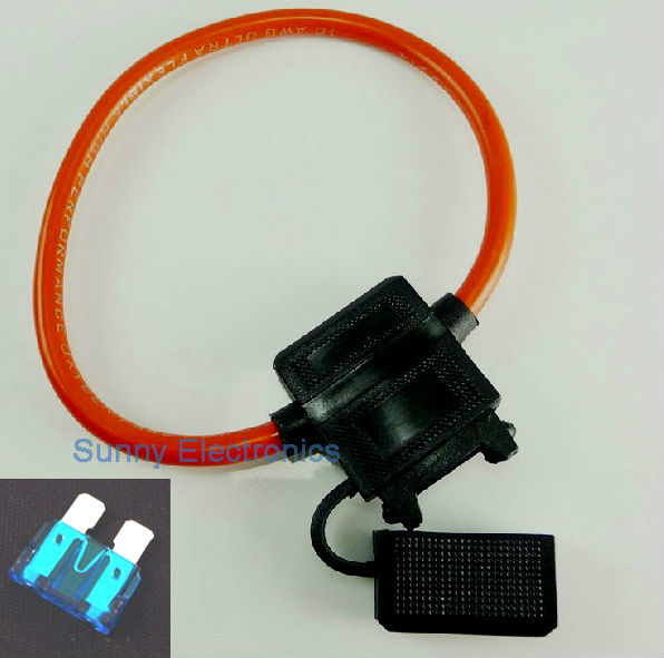

    So my cooling fans both have the typical atc fuse holder like this.
    I have had a couple of them melt due to poor connection and I'm looking for a different solution. I've looked at other fuse holders including anl but I would like to have the ability to change fuses quickly without using any tools. I've also considered circuit breakers either in the engine bay or in the cabin. I can't decide what I want to do and I am looking for opinions and ideas.url www.minimilitia.mobi/ www.applock.ooo/ www.7zip.vip/
