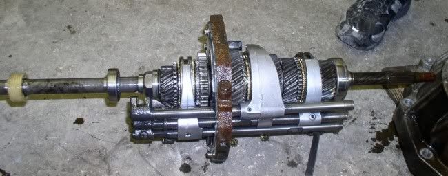

    I just found this picture of an S14 KA gearbox disassembled;
    It appears to have the same shifter forks as the S13 tranny pictures earlier in this thread.
    I found the picture in a thread on NicoClub where a guy was installing an S14 KA transmission onto his SR engine by swapping the bellhousings.
    http://forums.nicoclub.com/diy-swapp...n-t278158.html
